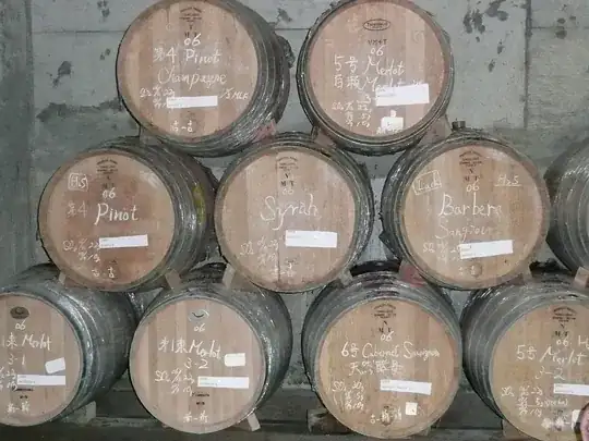

i'm trying to find a way to count barrels on an image.
For this I'm using Hough Transformation.
I tried my code first recognising eyes and it works excellent. But now the problems is when i try to find more than one center on the image.
For the eye case, I just use Hough with an accumulator, that later will tell me the position of the posible center.
but if I try with this image, it only prints a circle, instead of 10.
any recomendation?
Ignacio
  • 67
    Does the edge-detection step work as intended? In other words, are the circles well-represented in the output of edge detection? If information is already lost in this intermediate step, later steps wouldn't produce useful outputs either. – rwong Sep 28 '14 at 06:40
  • You can also consider a color-based (RGB, HSV or YCbCr) classifier of the wood color of the barrels. This will give you solid blobs of circles, which can then be analyzed by several algorithm approaches. – rwong Sep 28 '14 at 06:41
  • I'm working on matlab. So, if I first tried with: im = rgb2gray(im); ed=edge(im,'canny'); the image I obtain is : http://puu.sh/bRmQS/ca0197ac99.png It has a lot of noise, so I ignored it. After, I tried with: umbral=graythresh(im); bin=im2bw(im,umbral); ed=edge(bin,'canny'); and the image obtanied have well-represented circles, http://puu.sh/bRnvk/43f15a6bae.png but even though, I used the center detector, to see if it works for at least a barrel, but it doesn't. For the second method I obtain http://puu.sh/bRozq/caa6a1d212.jpg First method: http://puu.sh/bRoIG/d4da4fcf0d.jpg – Ignacio Sep 28 '14 at 16:45
