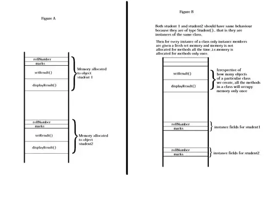

Now two different sets of memory is allocated for instance fields. Now my question is whether memory is allocated for methods (setResult and displayResult) twice or once?
Please see the following figure and can you help me saying which figure gives correct information.

The code for methods is part of the Class (more concisely, Class<Student>) and it is loaded into memory when the class is first loaded.
That said, when you execute any method additional memory is used, to allocate memory to parameters, local variables, temporary expression results, return values and so on. But such memory is allocated in the stack (the memory used when creating a new instance is allocated in the heap.
As per your question, it should be clear now that figure B is correct (although it does not reflect what happens when you actually call the method).

  • Ok. I'am 90% clear now....But a small doubt.. Suppose if i create a 10 objects of type Student then only 1 set of fresh memory is allocated to the methods present in class Student whereas 10 sets of fresh memory is allocated to store instance variables for 10 objects..Am i right? – Harish_N Sep 18 '14 at 17:08
  • Right. Think that it is not only the properties that take memory, there is a small overhead related to the instance itself (an instance of a class with no properties will use more than 0 bytes of memory). – SJuan76 Sep 18 '14 at 17:15

Instance fields (including property backing fields) get N-copies for N-objects.
Static fields get a single copy per class.
Methods are blocks of bytecode (or after JIT, blocks of native instructions) that are part of the program "image" or executable code segment. Methods are already part of the program image as it sits on disk. Once the image is loaded by the OS (or CLR), there is a single shared copy of the method code.
They aren't part of "heap" or runtime allocation in general, except in cases where you may use the hostable compiler to compile new methods on the fly. Methods don't get "allocated" like objects and they aren't "allocated" relative to the object creation. They merely exist as part of the program before a single object is ever instantiated. Even lambdas / delegates aren't allocated on the fly. The compiler creates classes on-demand to implement these other seemingly dynamic code objects, and they also exist as part of the bytecode image on disk.
