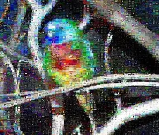

Speed is very data-dependent; Mona Lisa rushed through kuhnMunkres.py in 13 minutes, but the Scarlet Chested Parakeet took 16 minutes.
Results were much the same as random swaps and rotations for the Parakeet:
enter image description hereenter image description here
(kuhnMunkres.py on the left, random swaps on the right; original image for comparision)

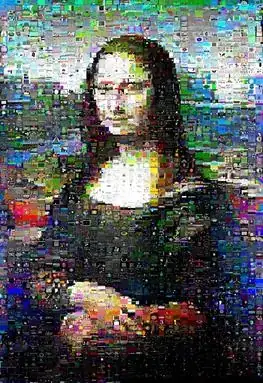

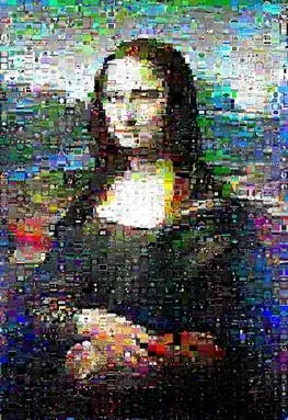

However, for the Mona Lisa image I tested with, the results were noticeably improved and she actually had her defined 'smile' shining through:
(kuhnMunkres.py on the left, random swaps on the right)
