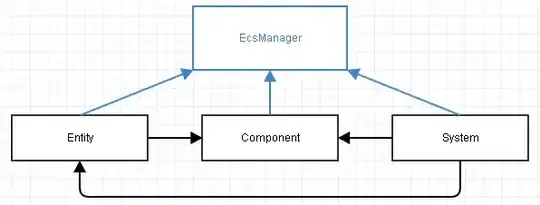

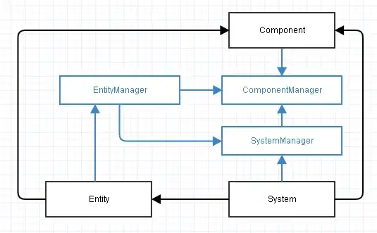

From what I can understand, you have something like this:
And all this tight coupling between these Managers is strictly for optimization purposes (using indices to cut costs on the size of a pointer while gaining easy spatial locality using a vector, e.g.).
In this case, I'm going to suggest something bizarre.

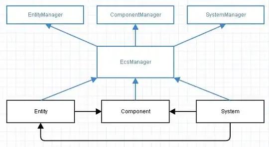

The idea is to get everything you need from a slightly more monolithic EcsManager object consolidating all of these concerns. This might seem like a borderline violation of SRP, but when you have these manager designs so tightly coupled together, it might simplify the practical implementation and design quite a bit over 3 classes that are really tightly coupled together.
Effectively that's what you have to me with these three managers so tightly coupled together. They want to become one manager to rule them all. I think we can get away with this because the needs of an ECS framework won't have varying requirements -- what an ECS needs is well-understood.
You could still keep these "sub-managers" if that simplifies the implementation of EcsManager a bit, though it might be even simpler if you just did this:

Your EcsManager then actually stores all the real, meaty data associated with the ECS framework. Your Entity and System and Component classes then just kind of turn into handles for convenience.
I think this is the easiest approach given the kind of design you are establishing, and also make achieving both thread safety and efficiency a little bit easier (though thread efficiency is tough here).
