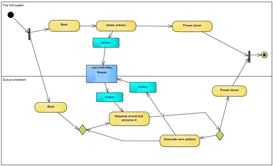

Which is the appropriate way of representing a queue processor in a UML sequence diagram?
I want to represent in the same diagram two systems that are loosely coupled through a queue. The first system, performs some actions and insert an action in a queue, the other system is always listening and when the event appears in the queue, it dequeues the event and processes it, generating new actions. They are both in the same diagram because it is to represent an integration use case that shows how both work together.
Should I create a life line representing the queue?
Should I represent the "listening" process as a loop box containing: a self-message with the label "listen", self-message for processing message and messages representing the sending of the outcome.

If you mean how to draw sequence diagram for something similar to this scenario..
..then I would also model the central "tuple space" or the central multi-agent coordination structure as dumb unconscious, but living actor which would metabolize some scent molecules whenever it "eats" something through the membrane. Agents in the neighborhood then might "smell" it and metabolize further..

    ... I a not completely sure that is an UML sequence diagram. – NullOrEmpty Aug 12 '14 at 14:25
    @NullOrEmpty you are completely right. My picture is [UML activity](http://www.uml-diagrams.org/activity-diagrams.html) diagram trying to describe the very same scenario that you want to draw in the form of sequence diagram. If this is the scenario you want to draw then I'm giving my (1,2,3)cents for your sequence diagram :) plus one more cent pointing that perhaps BPMN diagram might be also useful. Drawing the sequence diagram is up to you. I just tried to give you answer to your question with some explanation what is behind my answer – xmojmr Aug 12 '14 at 16:25
