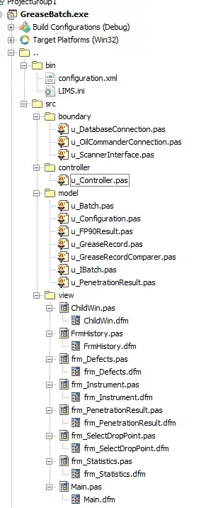

  • Circular References
I like to separate classes into different units.
ie: structure
keeping the user interface separate from the control logic and the model and data logic layer.
I can have a situation where 2 classes can reference each other. While this is a situation that for the most part I would like to avoid, there are occasions where this is needed.

This code is broken because the two classes include each other and this can not be done in pascal. This is not such a problem in C#. Solutions that I can think of: 1. include both classes in the same unit, although this is a problem if I do not think this suits the design. 2. Create another parent interface for B and inherit B from that, then this gets around it. Although this is messy for such a simple task.

You should look into Spring4D as it already contains nullable types (similar implementation as yours with a little extra operator overloading) and way more powerful collection types than those in the RTL. They are also interfaced based which is very handy because you don't have to worry about lifetime management especially when passing them around.
For cross referencing problems I am suggesting coding against interfaces and use these as reference in another implementation rather than 2 implementations knowing each other.
As for the MVVM part you might look into DSharp which has a first version of a Caliburn Micro port for Delphi. It is very early stage and hardly documented but you might get some ideas how to achieve MVVM in Delphi using loosely coupled GUI and business logic connected with data bindings. The Blaise Pascal magazine had two articles about it if you are more interested.
