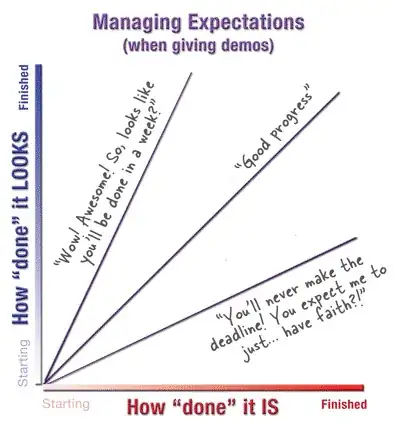

This is again reiterated in the blog post Don't make the Demo look Done which has this helpful graph:
How done it is to what it looks like
Note here the two options generally reflect the 'get the ui done' (and then the expectation is that you'll be done soon) and 'get the backend done' (and then the customer is worried about you missing the deadline).
How 'done' something looks should match how 'done' something is.

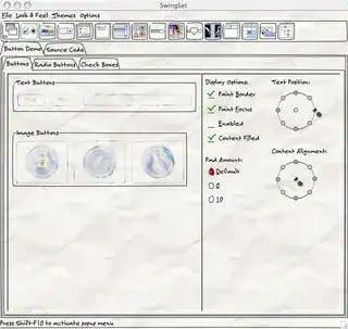

For those who are fighting with this in the Java Swing world, there's a look and feel called Napkin which makes it so that the UI doesn't look complete (even if it is).
The key here is to make it so that it doesn't look done. Having the UI look complete is a signal to many business users that the application is complete (even if its just a few static pages without any logic behind it or something built in an interface builder).
