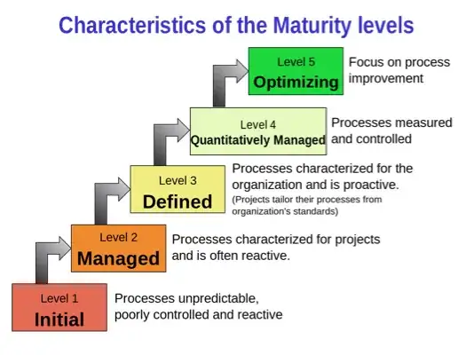

CMMI, on the other hand, is a quality management framework useful for large organizations that need to measure themselves in terms of their overall capability and maturity to demonstrate repeatable quality of software work they do. Organizations can use a mix of software development methods - Agile methods (such as Scrum/ Kanban/ XP/ BDD/ TDD/ etc), 'traditional' methods (Waterfall, Iterative) or a mix (Hybrid Agile), depending on their business needs. They can still use CMMI as an overall governance framework to measure and develop their software capabilities.
Definitely, as a solo developer, you don't need to worry about CMMI!
