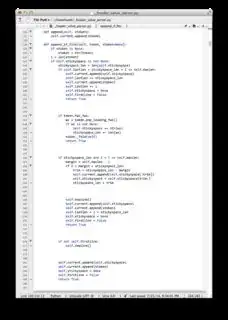

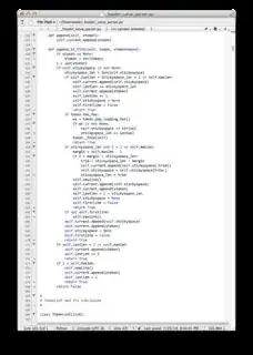

Lets actually look at this and get some code. This is from _header_value_parser.py
as writtenadditional whitespace
The text doesn't matter too much, but note that thats quite a bit less on the screen. One can't even get the full method in the page. And there is questions about where some of the blocks line up - the eye doesn't travel that well keeping things in line to far (it becomes more obvious in the full size image - does line 176 line up with the scope of 135 or 133?).
Its not about how many lines you are checking in (any one counting code checkin metrics is using source lines of code instead which discounts white space and may also discount comment lines). Its about keeping things in easy swap distance of the eye and the mind.
    I'm not sure the illustration you gave is relevant: the current method should have been split into at least five methods a long time ago. – Arseni Mourzenko Jul 26 '14 at 21:23
  • @MainMa it could be. What it *is* meant to show is how various spots where there are 4 or 5 lines separating blocks can make it difficult to keep the context of the entire block, along with difficulty with eye tracking to follow the scope of a given block. –  Jul 26 '14 at 22:09

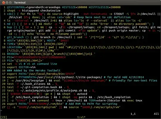

for some uses, having it 'all on one screen' is really helpful.
A good example if my .bashrc file which had got to 3 or 4 'screens worth' and was leading to more:
  • duplication for same settings
  • conflicting uses of same settings
  • forgetting what settings do
So in this case, I went to a lot of effort to 'compact' it down. In this case not just whitespace but making if then constructs fit on 1 line, e.g.
test -f ~/.bash_aliases && . $_
and was able to get it down to 27 lines which I can see all at once, even in a small terminal window, i.e.
