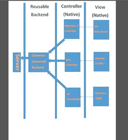

I want to build a cross platform(Android, iOS, Windows) mobile application.
I want the UX of the application to be different on the different platforms so that it will be more platform specific and does not force different platform users to stick to a common UI, as this common UI might not gel well in terms of look and feel with other native applications in their platform. However since it is the same application that I am trying to build across all platforms my backend will mostly be the same.
This image presents what I am trying to achieve. enter image description here
Is it possible to build different UI for each platform using native technologies like Storyboard(in iOS), XML(in Android), XAML(in Windows) and then bind these UI elements to native controllers. And making this controller use a common javascript backend for all the platforms.

To 1: I know that Xamarin has a proprietary way based on their implementation of .NET. You can use one language to build the common application backend and there are wrappers for the native libraries. They share the philosophy of building the GUI with the native libraries. It is not javascript though.

There are a couple of frameworks supporting this kind of thing -- Calatrava is Javascript/Coffescript focussed, or if you prefer to code your backend in Java look at Kirin (which I have worked on and worked with extensively). Check out my answer to this question for more information.

I guess you could do this quite simply with Appcelerator Titanium.
http://www.appcelerator.com/
This framework lets you write code in Javascript and it compiles it native code. So you can have for instance a Navbar which will be rendered natively by iOS, Android and so on.

    Because it didn't answer the question. The question is about shared javascript code on the client, (see the diagram). – Winston Ewert Jul 27 '14 at 22:21
    @WinstonEwert why would you not just build in a normal back end accessed via APIs rather than download backend code to the device (which will get your app rejected by Apple for doing). – Mackey18 Jul 28 '14 at 06:47
    @Mackey18 When I mean "Common Javascript Backend" I am talking about the backend in the client side. For example let's say we have a code which calls a server api and gets the results. My point being why do I have to make the same call in 3 different languages for the 3 different platforms. I might as well write one function in Javascript and re-use it. – HelpMatters Jul 28 '14 at 13:56
