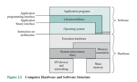

I'm trying to determine the technical details of why software produced using programming languages for certain operating systems only work with them.
It is my understanding that binaries are specific to certain processors due to the processor specific machine language they understand and the differing instruction sets between different processors. But where does the operating system specificity come from? I used to assume it was APIs provided by the OS but then I saw this diagram in a book: Diagram
Operating Systems - Internals and Design Principles 7th ed - W. Stallings (Pearson, 2012)
As you can see, APIs are not indicated as a part of the operating system.

  • API is part of the figure (left column, label *Application Programming Interface* for border between libraries and application programs) – Basile Starynkevitch Oct 05 '14 at 16:59
I think you are reading too much into the diagram. Yes, an OS will specify a binary interface for how operating system functions are called, and it will also define a file format for executables, but it will also provide an API, in the sense of providing a catalog of functions that can be called by an application to invoke OS services.
I think the diagram is just trying to emphasize that operating system functions are usually invoked through a different mechanism than a simple library call. Most of the common OS use processor interrupts to access OS functions. Typical modern operating systems are not going to let a user program directly access any hardware. If you want to write a character to the console, you are going to have to ask the OS to do it for you. The system call used to write to the console will vary from OS to OS, so right there is one example of why software is OS specific.

The diagram has the "application" layer (mostly) separated from the "operating system" layer by the "libraries", and that implies that "application" and "OS" don't need need to know about each other. That is a simplification in the diagram, but it's not quite true.
The problem is that the "library" has actually three parts to it: the implementation, the interface to the application, and the interface to the OS. In principle, the first two can be made "universal" as far as the OS is concerned (it depend on where you slice it), but the third part - the interface to the OS - generally cannot. The interface to the OS will necessarily depend on the OS, the APIs it provides, the packaging mechanism (e.g. the file format used by Windows DLL), etc.
Because the "library" is generally made available as a single package, it means that once the program picks a "library" to use, it commits to a specific OS. This happens one of two ways: a) the programmer picks completely in advance, and then the binding between the library and the application can be universal, but the library itself is bound to the OS; or b) the programmer sets things up so the library is selected when you run the program, but then the binding mechanism itself, between the program and the library, is OS-dependent (e.g. The DLL mechanism in Windows). Each has it's advantages and disadvantages, but either way you have to make a choice in advance.
Now, this doesn't mean that it's impossible to do, but you have to be very clever. To overcome the problem, you would have to go the route of picking the library at run-time, and you would have to come up with a universal binding mechanism that doesn't depend on the OS (so you are responsable to maintain it, a lot more work). Some times it's worth it.
You don't have to, but if you are going to put the effort to do that, there is a good chance you don't want to be tied to a specific processor either, so you will write a Virtual Machine and you will compile your program to a processor neutral code format.
By now you should have noticed where I'm going. Language-platforms like Java do exactly that. The Java runtime (library) defines the OS-neutral binding between your Java program and the library (how the Java runtime opens and runs your program), and it provides an implementation specific to the current OS. .NET does the same thing to an extent, except that Microsoft doesn't provide an "library" (runtime) for anything but Windows (but others do - see Mono). And, actually, Flash also does the same thing, although it's more limited in scope to the Browser.
Finally, there are ways to do the same thing without a custom binding mechanism. You could use conventional tools, but defer the binding step to the library until the user picks the OS. That's exactly what happens when you distribute the source code. The user takes your program and binds it to the processor (compile it) and OS (link it) when the user is ready to run it.
It all depends on how you slice the layers. At the end of the day, you always have a computing device made with specific hardware running specific machine code. The layers are there largely as a conceptual framework.
