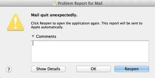

Example
  1. It shows the "here's what happened" (unexpected error)
  2. Tells user what to do (reopen Mail, even includes a shortcut to do this)
  3. Also has a "view details" if someone is curious to see the full technical error
  4. Provides notification an error error report is filed (see below)
Note that in some cases you may wish to make the error report be manual vs automatic.
