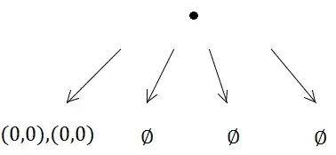

But then the first insert will trigger a subdivision (because the capacity is 1): Second insert, first subdivision
Both rectangles are thus put in the same subtree.

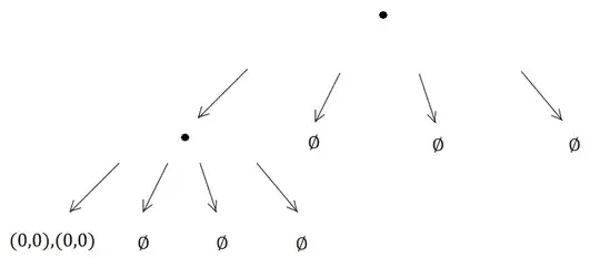

Then again, the two elements will arrive in the same quadtree and trigger a subdivison… Second insert, second subdivison
And so on, and so forth, the subdivision method will run indefinitely because (0, 0) will always be in the same subtree out of the four created, meaning an infinite recursion problem occurs.

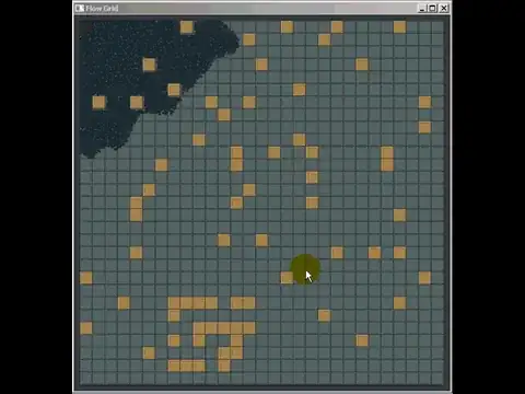

You can get a lot out of a plain old grid and I've actually beaten a lot of quad-tree and kd tree implementations used in commercial software by replacing them with a plain old grid (though they weren't necessarily the best implemented ones, but the authors spent a whole lot more time than the 20 mins I spent to whip up a grid). Here's a quick little thing I whipped up to answer a question elsewhere using a grid for collision detection (not even really optimized, just a few hours of work, and I had to spend most of the time learning how the pathfinding works to answer the question and it was also my first time implementing collision-detection of this sort):
