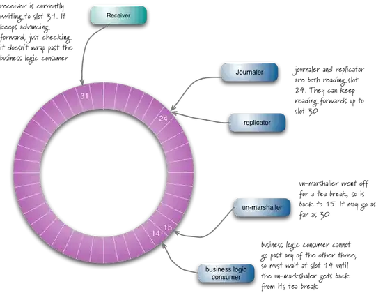

The Fowler Article providers a good primer, and this explanation:
At a crude level you can think of a Disruptor as a multicast graph of queues where producers put objects on it that are sent to all the consumers for parallel consumption through separate downstream queues. When you look inside you see that this network of queues is really a single data structure - a ring buffer.
Each producer and consumer has a sequence counter to indicate which slot in the buffer it's currently working on. Each producer/consumer writes its own sequence counter but can read the others' sequence counters. This way the producer can read the consumers' counters to ensure the slot it wants to write in is available without any locks on the counters. Similarly a consumer can ensure it only processes messages once another consumer is done with it by watching the counters.
A more conventional approach might use a Producer Queue and a Consumer Queue, each using locks as concurrency mechanisms. In practice, what happens with producer and consumer queues is that the queues are either completely empty or completely full most of the time, which causes lock contention and wasted clock cycles. The disruptor alleviates this, in part, by having all of the producers and consumers use the same queue mechanism, coordinating with each other by watching the sequence counters rather than using locking mechanisms.
