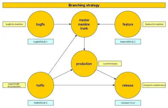

I'm using svn without branches (trunk-only) for a very long time at my workplace. I had discovered most or all of the issues related to projects which do not have any branching strategy. Unlikely this is not going to change at my workplace but for my private projects.
For my private projects which most includes coworkers and working together at the same time on different features I like to have an robust branching strategy with supports long-term releases powered by git.
I find out that the Atlassian Toolchain (JIRA, Stash and Bamboo) helped me most and it also recommending me an branching strategy which I like to verify for the team needs.
The branching strategy was taken directly from Atlassian Stash recommendation with a small modification to the hotfix branch tree. All hotfixes should also merged into mainline.
Planned Branching Strategy
The branching strategy in words
  • mainline (also known as master with git or trunk with svn) contains the "state of the art" developing release. Everything here was successfully checked with various automated tests (through Bamboo) and looks like everything is working. It is not proven as working because of possible missing tests. It is ready to use but not recommended for production.
  • feature covers all new features which are not completely finished. Once a feature is finished it will be merged into mainline. Sample branch: feature/ISSUE-2-A-nice-Feature
  • bugfix fixes non-critical bugs which can wait for the next normal release. Sample branch: bugfix/ISSUE-1-Some-typos
  • production owns the latest release.
  • hotfix fixes critical bugs which have to be release urgent to mainline, production and all affected long-term releasees. Sample branch: hotfix/ISSUE-3-Check-your-math
  • release is for long-term maintenance. Sample branches: release/1.0, release/1.1 release/1.0-rc1
I am not an expert so please provide me feedback. Which problems might appear? Which parts are missing or slowing down the productivity?

    I would recommend at least reading through some of Microsoft's material about branching strategies, its TFS focused but the basic ideas are all the same. – Ryathal Jun 06 '14 at 12:23
    I don't really understand the distinction between *production* and *release* and the direction of the arrows *trunk->production* and *production->release*. I would have expected a *trunk->release* arrow and a *release->production* arrow (with *production* effectively being an alias for one of the *release* branches). – Bart van Ingen Schenau Jun 06 '14 at 12:36
  • which branching model is efficient totally depends on project specifics. There can not be one-size-fit-all approach, see [To branch or not to branch?](http://programmers.stackexchange.com/questions/107884/to-branch-or-not-to-branch) – gnat Jun 06 '14 at 12:47
  • @BartvanIngenSchenau *production* is a "flat branch" which contains only the latest release. *release* is a "tree branch" and just a prefix. but maybe it is better to tag a release branch with "latest" and clone the tag. having a seperate *production* branch may cause inconsistency. – burnersk Jun 06 '14 at 14:17
The shortest answer: No single branching strategy is going to be optimal for every project, as such the strategy you have above will be perfect for some projects you have, and useless for others.

Mithaldu
  • 111
http://nvie.com/posts/a-successful-git-branching-model/ outlines a comparable branching model which the writer claims to have been using successfully on a number of projects.
Key points:
  1. two long-lived branches, master and development, with the former for production-ready code, and the latter being the integration branch.
  2. branches for feature, release and hotfix. These exist just for the duration of the relevant work, unlike the long-lived branches mentioned above.
  3. feature branches come off development and are merged back into it when complete. These typically exist in developer repositories only.
  4. release branches come off development and are merged back into development and master. The goal being to prevent big breaking changes to master causing problems for an imminent release. Hence these branches are typically created just before a release is due.
  5. hotfix branches come off master and are merged back into master and development. These are intended to address critical production issues.
