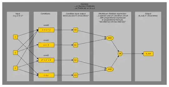

Suppose we have some software-under-test on which we want to do whitebox testing (i.e. we have the source code). The code naturally contains many of those decision predicates that we all know and love and that show up after strings like if, while, until etc.
An example of the decision predicate might be:
((x>y+z) AND (y<-3)) OR ((z²+x²<4) AND (z≤y))
An example of a decision predicate
This decision predicate accepts a triple (x,y,z) of integer values (say) and outputs a boolean, b_out.
The first-level functions which map (x,y,z) to {TRUE,FALSE} are called conditions (also atomic conditions) in the TTA syllabus.
Condition testing coverage
One attains "condition testing coverage" by running test cases until all the conditions found in the decision yielded at least once true and at least once false.
One can thus achieve condition testing coverage by running the following five test cases (for example):
Truth table achieving condition testing coverage
Each of the the b0, b1, b2, b3 shows up at least once with true and at least once with false. In some test cases, we do not care about a given value as it has no influence on the condition whose output we want to get right.

What is "condition testing" as defined above actually good for?
It won't help you ascertain the correctness of the decision predicate at all.
That is best done by a code inspection, letting a second team write the same expression and comparing outputs or running test cases at "boundary values" (e.g. here, for y = -4, -3, -2).
Checking the individual conditions strikes me to be more about testing the CPU's ALU or maybe testing the compiler output. It is certainly suitable for checking manually written assembler code or verifying manually assembled logic.
And this makes me think that "condition testing" could well be a leftover from the days where conditions were actually wired up on panels (for example in the ENIAC) and might thus be subject to wiring bugs. These days, the condition is written in high-level code and is exactly the one you conceptually want. While review might be useful, a testing of the condition is just a waste of time.
Or am I missing something?
