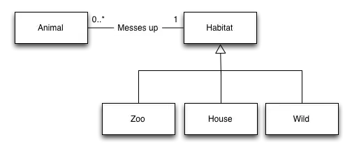

I've made a simple class diagram that describes your domain: enter image description here
Each Animal has a Habitat it messes up.
The Habitat does not care what or how many animals it has (unless it is fundamentally part of your design which in this case you described it is not).
But the Animal does care, because it will behave differently in every Habitat.
This diagram is similar to the UML Diagram of the strategy design pattern, but we will use it differently.
