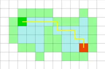

I am currently studying pathfinding and I came across A* algorithm from this site https://github.com/qiao/PathFinding.js
I tried to test A* with bi-directional and it is working great.
An a* path
What I wanna do now is increase the path that it can make without adding more nodes in the openlist.

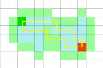

For example is that the algorithm was able to find a path but as you look at the results it can still generate one more path without touching the other path.
two distinct paths
Any ideas?

For finding
just remove the squares of the first path (except the start and ending square) from the map and run A* again.
Doc Brown
  • 199,015
  • 367
  • 565
  • meaning make it like blockable? though.. if you will run the pathfinder again.. isnt it using too much resources? there is really no other way? – Macross Mar 13 '14 at 23:08
  • @Macross: yes, you have to block the squares you want to exclude from your second search. No, I don't think there's a better way, since when squares become blocked, this can change the whole topology of your search graph. – Doc Brown Mar 14 '14 at 04:39
  • well, I guess you are right... I tried to apply it and it also gives gives quite some good results. Thank you... – Macross Mar 14 '14 at 17:46
