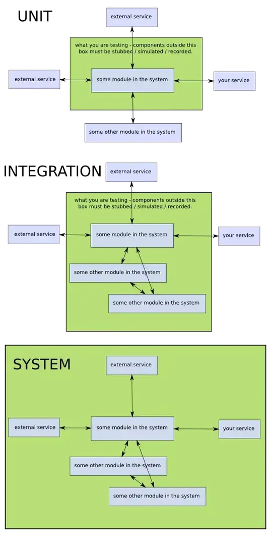

I have put a simplified schematic illustration below. components inside the green box are tested, whereas components outside the green box are stubbed (faked, mocked, etc.)
for ruby/rspec there are tools (e.g. capybara) to assist with system tests, frequently called acceptance tests, when they are used to demonstrate a system does what it is supposed to.

    I don't think your second diagram shows an integration test; you are not integrating with anything. It looks more like a larger-scale unit test. An integration test would have some external services using the real version, some not. – soru Apr 03 '14 at 23:59
  • +1 **@soru:** Agree, integration to me means a connection to a interface that is beyond your control. If the connection is within the code-base, it is not integration, but the fusion of the code itself. – blunders Apr 04 '14 at 02:56
  • @soru, blunders, please consider that your idea of integration testing might not be the only one, or even the most commonly used, for instance: http://www.techopedia.com/definition/7751/integration-testing http://msdn.microsoft.com/en-us/library/aa292128%28v=vs.71%29.aspx http://en.wikipedia.org/wiki/Software_testing#Integration_testing . That said, it would have been possible to include the box in the green area, depending on what the service is or does (I was thinking e.g. of a REST-API of some kind and left it out) – kr1 Apr 04 '14 at 07:56
  • Yes, there are always multiple definitions; at the very least a right one and a wrong one. From your link: 'Integration testing is any type of software testing that seeks to verify the interfaces _between_ components against a software design', and 'verify interaction _between_ various software components'. – soru Apr 04 '14 at 11:22
  • @soru, you shouldn't worry about being wrong, that's not the point here. Btw, there are actually 3 links to get a broader picture. The question you have raised is also quite marginal in my answer. The central point is that there is a separation between what is covered by your test and what is not. These must be conscious choices and determine where to use stubs and where not. – kr1 Apr 04 '14 at 18:30
