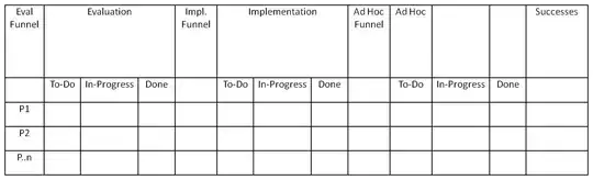

A. First, just to get an overall “system view”, I gather the three boards you have shown are ONLY for tracking the Architects’ work, not the rest of the Development Department’s work, is that correct?
B. Given the way you have described it, it would appear that each of the Funnel Board columns is essentially the “Ready” column for the corresponding sections of the Main Board.
  1. Is it necessary to have the separate Funnel board? Would it not be simpler to have a single board – where you have “Funnel” or “Ready” columns for each section of the Main Board?
  2. Similarly, the Successes Board can be seen as a large column to the right of the Main Board where all successfully completed work accumulates for a period of time?
  3. So, depending on the number of projects in the funnel and in progress (in any of the stages) at any time, would it be simpler to manage these all in a single Board which has the following design -
Of course, it is very likely you have already evaluated this and decided it might be too big to manage in a single Board! (You could consider dropping the To-Do lanes in each section since the Funnel lane might serve that same purpose?)
C. In terms of the Main Board design, it really depends on what your overall goals are for implementing Kanban. Some questions on the board design:
  1. Do you want to improve Lead/ Cycle Times for individuals (which would be easy to do in the current design) or for different types of Projects (which might be more tricky (but not too much given your color-coding)? If it were the latter, you might prefer to have the lanes defined not by people but by Project type (similar to class of service)?
  2. Is it ever possible that you might have two architects working on a single project? If so, having lanes by people would make it difficult to model that, unless you had two cards for the same project against each person?
  3. Is it possible that different types of Projects may have a different workflow? For example, might a customer project require greater scrutiny (validation or testing or reviews) than the others? If so, Kanban allows you to have different workflows for different types of work, which would not be possible in this design.

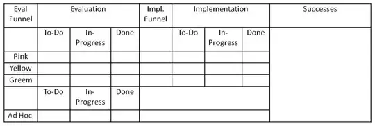

    If any of the above points 1-3 make sense in your situation, I would suggest that you might want to consider lanes not based on people but on some other aspect. From what you have talked about, doing it by Project Type seems to be one option – but I am sure there are other criteria possible as well.
  4. Another suggestion, just for more intuitive visualization – since people associate the left-to-right flow (or right-to-left in some parts of the world) to be the direction of the flow, do you think having the Ad Hoc section to the right of the Implementation columns might be confusing? My own preference would be to have Ad Hoc projects having their own separate Swim Lane.
    So, the Main Board might look as follows –
  5. In all of the above, you could have some “avatar stickers” to show which architect(s) was work on each project that you could stick on the Project cards. If needed, a legend on one side of the board might explain which avatar was which Architect.
  6. Finally, a bigger question – you stated initially that these boards were meant to track projects that the Architects were accountable for. These projects, I presume, are part of (larger) projects that are being done by the overall Development department. How are you planning to show dependencies between those (bigger) projects and the architects’ work?
