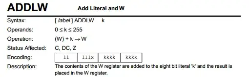

Look at the instruction set documentation, and you will find entries like this one from a pic microcontroller for each instruction:
example addlw instruction
The "encoding" line tells what that instruction looks like in binary. In this case, it always starts with 5 ones, then a don't care bit (which can be either one or zero), then the "k"s stand for the literal you are adding.
The first few bits are called an "opcode," are are unique for each instruction. The CPU basically looks at the opcode to see what instruction it is, then it knows to decode the "k"s as a number to be added.
It's tedious, but not that difficult to encode and decode. I had an undergrad class where we had to do it by hand in exams.
