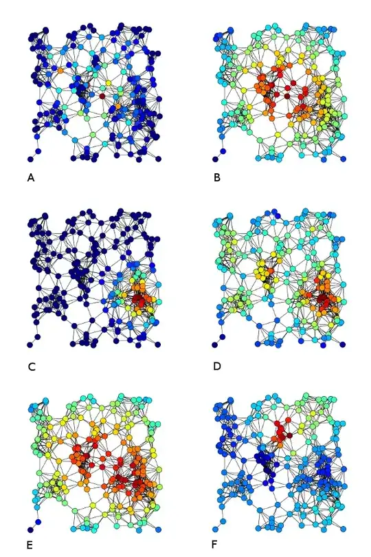

I've found the following picture a good key for the difference between different measures (although undirected graphs are depicted, some apply to directed as well). Degree centrality [D] is straightforward: who has most in/out links. Eigenvector-centrality [C] captures the notion of indirect influence better. See Centrality on wikipedia for the definitions and details.
Undirected centrality measures
