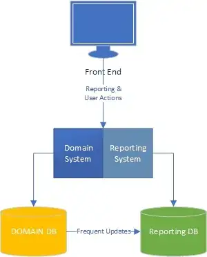

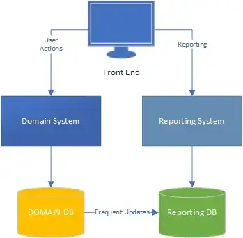

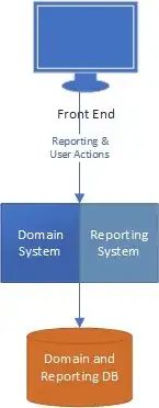

It's 4 years later and I just found this question again, and I have what is, to me, the answer.
Depending on your application and it's specific needs, your domain/transaction database and your reporting can be separate "systems" or "engines", or they can be serviced by one system. They should, however, be logically separate - which means they use different means of retrieving and providing data to the UI.
I prefer them to be physically separate (in addition to being logically separate), but a lot of times you start them out together (physically) and then, as the application matures, you separate them.
Either way, again, they should be logically different. It's ok to duplicate business logic in the reporting system. The important thing is that the reporting system get to the same answer as the domain system - but chances are it will get there via different means. For example, your domain system will have a ton of very strict business rules implemented in procedural code (likely). The reporting system could implement those same rules when it reads the data but would do so via SET based code (eg. SQL).
Here's what an evolution of your application's architecture might realistically look like as it evolves:
Level 1 - Logically separated domain and reporting systems, but still in the same codebase and database
Level 2 - Logically separated domain and reporting systems, but separate databases now, with syncing.
Level 3 - Logically and Physically Separated domain and reporting systems, and separate databases with syncing.
The main idea is that reporting and domain have radically different needs. Different data profiles (reads vs writes and updates frequency), different performance requirements, etc. So they need to be differently implemented, and that necessitates some duplication of business logic.
It's up to your business to devise a way to keep the business logic of the domain and reporting systems up to date with each other.
