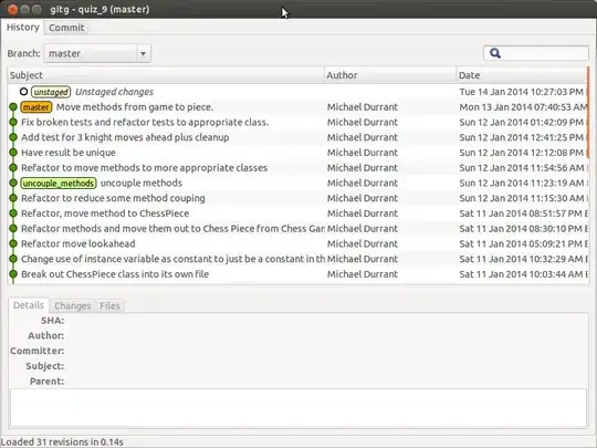

Think about what you need and what you're going to use it for - your requirements.
If it's code for a spike for a couple of hours, just write it may be ok.
If you get to the point where you start to (or feel the need to) make backups to 'save working versions', then a version control system can help.
Also, if you get code to a working point and want to do your own spike, it can be handy to do a branch which you can then merge back in, as shown below where I am the sole contributor and this repo has never been pushed anywhere ('uncouple methods' was a branch I did for a spike): enter image description here
Of course if you are also maintaining software that has several versions and/or releases, a version control system is very helpful, especially with the ability to merge changes.
