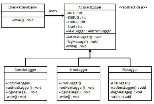

Logging is usually implemented with the Chain of responsibility pattern. Of course you can (and I would) combine that with a Facade. I really wouldn't use Listener(s) or Observer(s) myself.
Chain of responsibility - Logger

Chain of responsibility seems to be a good pattern when your output can landup at multiple places. In the UML you have different logger one that directs to console, other to errorFile and 3rd simply info logger.
Usually I have seen that logLevels are different but the logging file is same.
