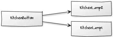

The name includes the term "inversion" because traditionally (y'know in the old dark ages of programming) you wrote software structures that had higher level modules depending on low level modules. E.g. it made sense to have a ButtonAtKitchen handling inputs for a KitchenLamp1 and KitchenLamp2. Unfortunately that made software a lot more specific than it needed to be and the object graph would look like this:
ButtonAtKitchen handles KitchenLamp1 and KitchenLamp2

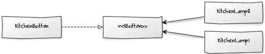

So when you make the software more general, by adding "contracts". Notice how the arrows in the object graph "inverts" the direction. That kitchen lamps are now dependent on a Button. In other words the details are now dependent on abstractions instead of the other way around.
KitchenButton now has a IButton abstraction that the kitchen lamps are dependent on
Thus we have a more general definition of DIP, also detailed in the original article of DIP by Uncle Bob.
A. High level modules should not depend on low level modules. Both should depend on abstraction. B. Abstractions should not depend upon details. Details should depend on abstractions.
