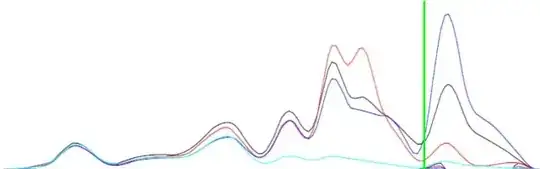

==EDIT== For clarification I have included an image.
Sample curves
The difference between the two curves (black and blue) may not be the same but will have complementing shapes.
Background: The functions are projected density of states (PDOS) of atomic orbitals of a compound. So I have states for s,p,d orbitals. I want to determine whether the material has s-p, p-d or d-d hybridizations (orbital mixing). The only data I have is the PDOS. If say the PDOS of s orbital (function f(x)) has the peaks and valleys as at the same energies (x values) of the PDOS of p orbital (function g(x)) then there is s-p mixing in that material.
