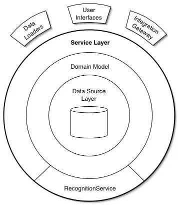

  • Service layer. This layer talks to the domain layer and serves the client requests. In our case the service layer is quite simple - it relays requests to the domain layer, handles security and few other cross cutting concerns. This is not much different to a controller in MVC application - controllers are small and simple.
  • Client layer. Talks to the service layer through SOAP.
We end up with the following:
Client -> Service -> Domain -> Data
We can replace client, service or data layer with reasonable amount of work. If your domain logic lived in the service and you've decided that you want to replace or even remove your service layer, then you'd have to move all of the business logic somewhere else. Such a requirement is rare, but it might happen.
Having said all this, I think this is pretty close to what Martin Fowler meant by saying
These services live on top of the domain model and use the domain model for data.
Diagram below illustrates this pretty well:
http://martinfowler.com/eaaCatalog/serviceLayer.html
http://martinfowler.com/eaaCatalog/ServiceLayerSketch.gif

The concept of Service layer can be viewed from DDD perspective. Aaronaught mentioned it in his answer, I just elaborate on it a bit.
Common approach there is to have a controller that is specific to a type of client. Say, it could be a web-browser, it could be some other application, it could be a functional test. The request and response formats might vary. So I use application service as a tool for utilizing a Hexagonal architecture. I inject there infrastructure classes specific to a concrete request. For example, that's how my controller serving web-browser requests could look like:

So application service is an environment that I set up for running business-logic. It's where the model classes are called -- agnostically of an infrastructure implementation.
So, answering your questions from this perspective:
Is it a means to simply extract logic from the controller and put it inside a service instead?
No.
Is it supposed to form a contract between the controller and the domain?
Well, one can call it so.
Should there be a layer between the domain and the service layer?
Nope.
