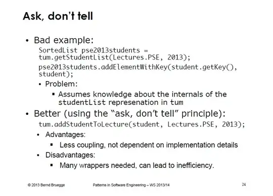

I'm taking a course on design patterns in software engineering and here I'm trying to understand the good and the bad way of design relating to "coupling" and "cohesion".
I could not understand the concept described in the following image. enter image description here The example of code shown in the image is ambiguous to me, so I can't quite clearly get what exactly "Ask, don't tell!" approach mean. Could you please explain?

The first example tells the object in question, "I need these accessors and this data from those accessors". That may be fine and good but it requires that you know how the object accesses those things.
The second example asks the object "Can you do this thing?", and then the object either returns that operation or fails. There is no requirement of internal knowledge of the object, thus facilitating the idea of loose coupling since I can then freely change the underlying object's interal functionality so long as the accessor interface, the "tum.addStudentToLecture(...), remains the same.
"Ask" code breaks when its object changes the details of its operation. It has to state the types the object will be returning, it has to make assumptions about the mutability and synchronicity of those returns, and it forces other objects to implement "Ask" code to provide the other details they need to cooperate.
"Tell" code, by contrast, keeps all of types and implementation considerations in the hands of the object that can change them. When they do change, external "Tell" code doesn't have to be revised in order to remain valid.
To make it concrete using your example, let's say that tomorrow, you or a co-worker:
  • Need to make the list of students accessible asynchronously and can't use a SortedList.
  • Need to store students by different keys in multiple containers, so student.getKey() becomes ambiguous or misleading.
  • Need to query the elements of pse2013students by more than a simple key.
If you used the "Ask" code, you need to revise both the tum object and the method that employs it in the example. If you use the "Tell" code, you only needed to make changes to the tum object. It doesn't look like much of a difference when your code base is two lines, but in a non-trivial program, it can become a severe maintainability hazard.

So in the "bad" example, when the code "tells" the tum object how to add a student to the list. Now the invoking classes is messing around with the internals of how the student list is kept. If the author of the tum object decides to replace:
getStudentList(Lectures.PSE,2013)
with a new function
getStudentMap(Lectures.PSE, Campus.Main, 2013)
you have to change your code to get it to work the way it did before because of something they did. Upgrading common utility library would potentially become a nightmare be it might break tons of code. Yet the utility library might have some critical security fix so you might have to upgrade it.
In the good "ask" example, the code invokes a function inside the tum object to add a student to the list. The author of the tum object is maintaining this functionality and it is their responsibility not yours. This is a good thing. They are now obliged to keep it working correctly and if it doesn't now they are obliged to fix it, not you.
In addition, there might be other requirements you are not aware of that they might be doing. For example, checking the student records and if this is the very first lecture a student attends, mail them a welcome letter. Your class would have no idea about that (or care) and yet now if that became a requirement you would have to add and maintain that to your code.
