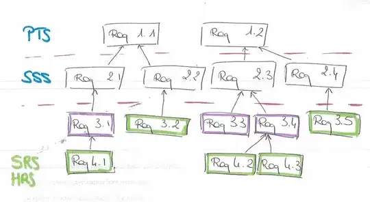

Our system is a complex one, and some of the requirements in the SSS needs to be refined twice to be at the right level in the SRS (means that software people can understand the requirement to make their coding). But, with this document architecture, I can only refine once the requirements from the SSS. The second problem is that only a part of the requirements from the SSS needs to be refined twice. The other part only need one refinement.
On the picture below, the green boxes are requirements at the right level for SRS or HRS. And purple boxes are intermediate requirements which can not be included in SSS since they are design requirements. Where can I put these purple requirements ??
Is there someone who has already encountered this problem ? Should I write two documents at SRS level ? Should I include intermediate requirements in SSDD ? Should I includes the two refinement levels (purple and green) in the same SRS document (not sure that's possible since a SRS is only for one component) ???

The purpose of specification refinement is twofold:
  • Translate higher level requirements to something usable by developers: e.g., from I want a "Google Maps" with space imagery to The spacecraft shall follow a polar orbit to a bunch of equipements --sensors and actuators-- and a software implemented control loop involving quaternions and some real time OS.
  • Provide a way to check that every customer need has been implemented, through traceability.
Therefore, you only have to make clear whether Req 3.1 is entirely implemented by Req 4.1, so that the developer either focuses on Req 4.1 (and I would put Req 3.1 in SSS) or has to implement both Req 3.1 and Req 4.1 (and I would put Req 3.1 in SRS).

Since the question is vague I'll answer 2 ways.
1) Assuming that your system only has 1 configuration item, which is why that document appears to be missing in your above description then you are merely mapping SSS Requirements to Hardware and Software Documents. In which case, there are no "Purple" requirements. The people writing the SRS/HRS are responsible for turning the SSS Requirement (possibly using the SSDD and any DIDs as a reference, which might be where your "purple" requirements come from) and turning those SSS and derived requirements into the appropriate SRS/HRS requirement.
2) If your system has multiple Configuration Items then the SSS Requirements are mapped to the "Configuration Item" Performance Specification Document. This document is where your "Purple" Requirements would go along with module specific reinterpretations of the SSS Requirements mapped to it (again possibly using the SSDD/DIDs as reference). Then that document is used to map down to the hardware and software which are then used to create a separate SRS/HRS. I suspect this is what you are trying to do.
