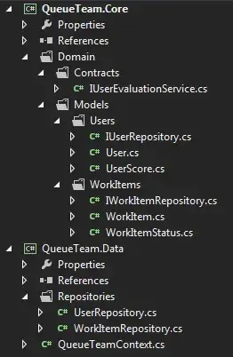

For a real-world example, this implementation of DDD seems to be wrong:
The WorkItem domain models below are nothing but property bags, used by Entity Framework for a code-first database. Per Fowler, it is anemic.
The WorkItemService layer is apparently a common misperception of Domain Services; it contains all of the behavior / business logic for the WorkItem. Per Yemelyanov and others, it is procedural. (pg. 6)
So if the below is wrong, how can I make it right?
The behavior, i.e. AddStatusUpdate or Checkout, should belong in the WorkItem class correct?
What dependencies should the WorkItem model have?

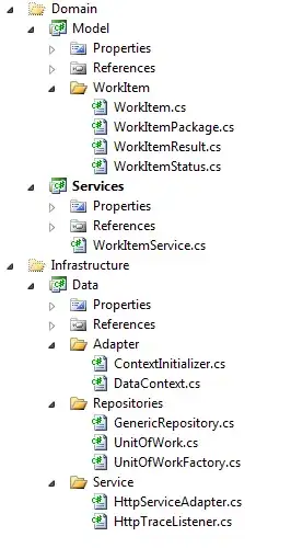

  • Good points. Where would the AddStatusUpdate method belong then, in Data or another project in the Infrastrcture? What's an example of any behavior that might theoretically belong in WorkItem? Any psuedo-code or mock-up would be greatly appreciated. My example was actually simplified to be more readable. There are other entities, and for instance the AddStatusUpdate has some extra behavior -- it actually takes a status category name, and if that category doesn't exist, the category is created. – RJB Oct 07 '13 at 17:20
  • @RJB Like I said, AddStatusUpdate is code that is using the domain. So either some kind of webservice or application that uses the domain classes. And like I said, you cannot expect any kind of mockup or pseudocode, because you would need to make whole project of big enough complexity to showcase real advantage of OOP domain model. – Euphoric Oct 07 '13 at 20:36
