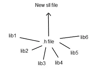

Take the following: One .h file with references to 6 statically linked libraries: you would need to include 7 files in your project to get full functionality
inclusion example 1
One SLL which was created from said .h File would require only the new SLL to be included for linking at compilation:
inclusion example 2
Hope this helps and that I have understood what you were asking.
