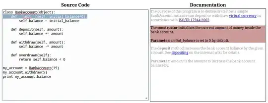

A mock-up to help clarify the question:
Dual Editor Mockup
When the cursor is at a particular line in the source code (shown with a blue background, above), the documentation that corresponds to the line at the cursor is highlighted (i.e., distinguished from the other details). As noted in the question, the documentation would stay in lock-step with the source code as the cursor jumps through the source code. A hot-key could switch between "documentation mode" and "development mode".
Potential advantages include:
  • More source code and more documentation on the screen(s) at once
  • Ability to edit documentation independently of source code (regardless of language?)
  • Write documentation and source code in parallel without merge conflicts
  • Real-time hyperlinked documentation with superior text formatting
  • Quasi-real-time machine translation into different natural languages
  • Every line of code can be clearly linked to a task, business requirement, etc.
  • Documentation could automatically timestamp when each line of code was written (metrics)
  • Dynamic inclusion of architecture diagrams, images to explain relations, etc.
  • Single-source documentation (e.g., tag code snippets for user manual inclusion).
Note:
  • The documentation window can be collapsed
  • Workflow for viewing or comparing source files would not be affected
  • How the implementation happens is a detail; the documentation could be:
    • kept at the end of the source file;
    • split into two files by convention (filename.c, filename.c.doc); or
    • fully database-driven
  • By hyperlinked documentation, I mean linking to external sources (such as StackOverflow or Wikipedia) and internal documents (i.e., a wiki on a subdomain that could cross-reference business requirements documentation) and other source files (similar to JavaDocs).

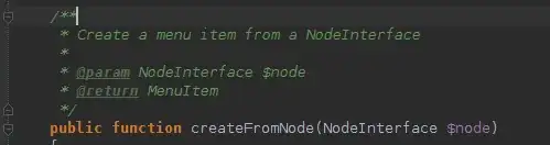

  • Most IDEs support collapsing code/comments, with the end results being the following: enter image description here
    Instead of the normal:
Make the code more readable, in case you don't need the comments.
