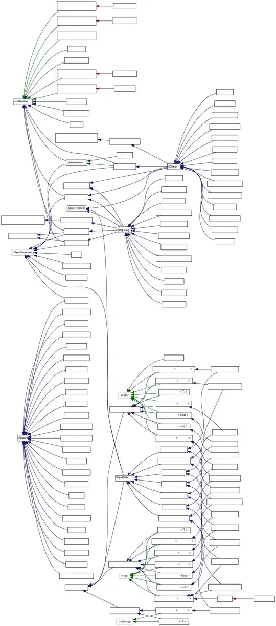

Our team has recently inherited a relatively large project from another company (~250k lines). It was developed using C++Builder and we intend to port the Ui side to Qt. Most of the Ui code is separate from the business logic (yay!) but the logic side is quite a mess.
There is a lot of diamond inheritance going on (virtual inheritance thankfully) but it makes understanding the code quite difficult to do.
We've got very little documentation to go on, what's there is out of date (comments included).
I generated class diagrams using Doxygen, here's the most complex one (I had to remove most of the class names but kept some of the more important ones and kept the standard C++ data types and std classes, yes, they inherit from std)
confusing inheritance
So far we've been able to convert the base program to Qt and we're at a point where we can start converting the program's functionality bit by bit. Problem is, is it worth it long term? We would like to be maintaining this software as our own long term.
Is there a general approach we should take to untangling this kind of inheritance mess or should we simply redesign from scratch and only keep bits and pieces of the existing code as we go?

  • Redesign by encapsulation. The diamond inheritance suggests there is not enough isolation of the independent functionality. Just as encapsulation helps one refactor a global state machine and increases the ability to understand a system by requiring only that one understand the interfaces of the encapsulated black boxes and not the implementation, further breaking down the classes is the same on a smaller scale. – DaveMorganTexas Aug 21 '15 at 00:27
