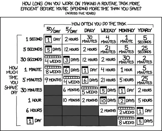

Some programming environments such as Visual Studio have the ability to store code snippets, and even come with a template code generator (T4). But the point of automation is to save time. Consult this chart first, before writing the template:
Is it worth the time?
http://xkcd.com/1205/
