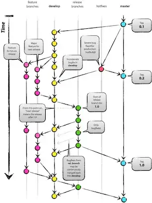

Lets look at the git-flow model and see how it applies.
The master branch (blue) is the release branch - for tagging. It is not the mainline. The mainline is actually the develop branch (yellow). The release branches (green) are the packaging role. Low risk development happens in the mainline, high risk development happens in the feature branches (pink). In this model, accumulation is done in the develop branch. Maintenance are considered 'hot fixes' which are red.
While the role policies aren't exact match (each product has its own slightly different lifecycle), they are a match.
Doing this should simplify your branching policy and make it easier for everyone involved.
