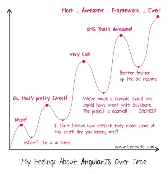

    So, not to criticize but wouldn't the negative statements on the chart actually be below the x axis? That would make the chart look like an ever expanding sin wave. I know its not your chart, but its bad science. – QueueHammer Sep 06 '13 at 16:17
    QueueHammer you must be real fun at parties. :-) – Thomas Stock Nov 07 '13 at 09:29
  • What's wrong with functions inside $(document).ready()??? – user1873073 Jan 08 '14 at 21:12
    I am totally stuck in the two lower points of the wave on either side of the 'Very Cool!' bubble, as one combined shitty angular hell. – MetaGuru Jul 10 '14 at 20:32
  • He has only one `ng-controller="main"` through all pages ... I'm not sure if he's doing this correctly. – Gaui Aug 11 '14 at 23:50
  • This graph if anything demonstrates everything that is wrong with Angular. "The Angular Way" effectively means "Learn crazy way no one else does stuff, for good reason". – MrYellow Apr 27 '15 at 22:18
  • @MrYellow - graph does not reflect resent developments in AngularJS. Thus it is much different from 2013 :)) – Yusubov Jun 12 '15 at 19:35
