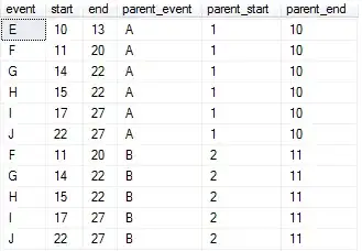

This problem is effectively equivalent to tree traversal within a table with parent references. You can construct the tree structure through a self join using a query like this:
SELECT
    b. *,
    a.event as parent_event,
    a.start as parent_start,
    a.end as parent_end
FROM
    interval_test a
        join
    interval_test b ON b.start >= a.end
order by parent_start, start
Producing a result that looks like this:
Parent child hierarchy for showing potential predecessor relationships
Note: the result is truncated to save space, but you get the idea...
Each of the possible successors of an event (those with an end >= start of the predecessor) can be thought of as a child in the tree. You want to find the tree path down the tree that minimizes the start time at each step.
