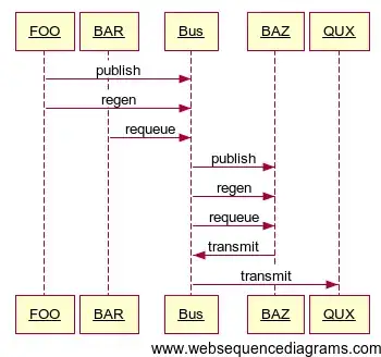

I'm looking for a way to clearly diagram how multiple applications communicate via a service bus. The best I've come up with so far is a sequence diagram, but I really don't like that. Sequence diagrams necessarily relate some sort of sequence, and that's really not what I want. Furthermore, since every service communicates with the service bus and sequence diagrams place each service on a separate column, as the number of services increases, you end up with a lot of overlapping arrows.
For example, given 4 services FOO, BAR, BAZ, and QUX:
  • FOO publishes messages of type publish and regen.
  • BAR publishes messages of type requeue.
  • BAZ subscribes to messages of type publish, regen, and requeue, and publishes messages of type transmit.
  • QUX subscribes to messages of type transmit.
  • Any service can publish any message type at any time (there is no implied sequence).
What kind of diagram should I use to clearly and unambiguously represent this information?
Here's the best I've come up with so far:
Sequence diagram
That would be awesome. Unfortunately, I don't think it is possible for configurations of any complexity. A sequence diagram for simple scenarios is probably as good as anything else.
Components on a bus both publish and subscribe to messages. Some of the messages may be causally related, forming a protocol. It it difficult to show this graphically, especially the causal relations, when there is more than one protocol in play on the bus.

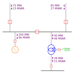

Electrical bus diagrams have been around for a long time
electrical bus diagram
but they deal with a quantity of a uniform commodity (electrical power) not discrete signals.
I like to show messages sent (on the right) and received (on the left) by each component (and the subchannel/topic structure, if applicable), but again for anything but the simplest of scenarios the diagrams quickly become cluttered and nearly useless.

  • Thanks for taking the time to respond. For complex orchestrations of messages ('conversations' within 'protocols') yes, sequential diagrams are fine. But at the moment I'm trying to tackle a high-level overview of what service are responsible for publishing a given message type and what services may be affected by a given message type, not really the sequence of messages involved. I'm hoping for something standardized, but if I end up inventing my own, it would probably look a lot like the electrical bus diagram you gave as an example. – p.s.w.g Aug 22 '13 at 20:14
  • @p.s.w.g: you're welcome. Added example diagram, built using Balsamiq Mockups. I use small circles to make the connection points stand out, in case I need to annotate gateways or other constraints – Steven A. Lowe Aug 22 '13 at 20:29
  • Yeah something like this would work. I think I prefer the little arrows in the electrical diagram to having a left/right distinction, but this gives me some ideas. – p.s.w.g Aug 22 '13 at 20:41
  • @p.s.w.g: i found the little arrows got in the way for larger diagrams ;) Electrical components rarely (that i've seen) consume and produce power, so the arrows are static. That's why I went with the left/right distinction (arbitrarily). I also try to put incoming messages closer to the box for the component, and outgoing messages closer to the bus line - but it's definitely not an ideal solution. Looking forward to seeing what you come up with! – Steven A. Lowe Aug 23 '13 at 15:26
