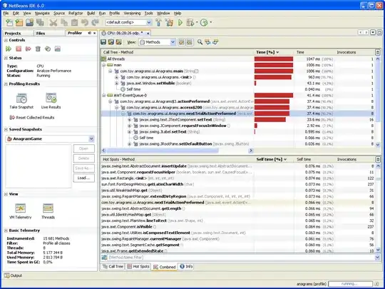

There are several such applications. Sometimes, these are built into the IDE itself. The netbeans ide is one such tool that has a profiler built in. enter image description here
