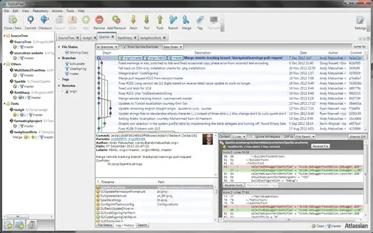

They want [something that can] show their changes across all projects instead of trying to remember what project they made a change [to].
Sourcetree (a free-as-in-beer GUI Git frontend) allows you to register multiple repositories, organise them into logical groups, and then view status across all of them at once: screenshot
I am not affiliated with them in any way.

  • Smartgit does this too ... but better. – CAD bloke Feb 27 '16 at 08:50
  • @CADbloke how is the interface for SmartGit nowadays? I remember a year or two back I was deciding between the two, and SourceTree was clearly easier to use than SmartGit, which was rather spartan and problematic. I couldn't even get my diff tool to work well – user120242 Mar 10 '16 at 03:10
    I like it. SourceTree went off the rails in recent times. I paid for Smartgit & use it for Hg too. I like the diff tool in it. They are pretty similar but I think Smartgit made more progress lately. – CAD bloke Mar 10 '16 at 03:14
  • Have you used Beyond Compare, I find this diff tool better than the others? How does it compare? – user120242 Mar 10 '16 at 04:27
  • I recognize this is pretty old but either Sourcetree has gone backwards or I just can't find that left hand overview pane. I have the mid-left one (File status, Branches, etc.) that is per repo, just not the one for multiple repos. Any ideas how I get it (or is it no longer or?) – JoelAZ Aug 09 '18 at 23:44
  • @JoelAZ They've since changed to a tabbed interface. If you click the '+' button in the tab bar, you'll get to what used to be the overview pane. I'm not convinced it's an improvement. – Ron MacNeil Aug 10 '18 at 01:39
  • @RonMacNeil OH geez. Is THAT the equivalent of that pane? ffs. No not an improvement at all. Better to have left that pane, made it pinnable and/or slide/hideable imo if some ppl wanted the real estate back but burying it on another separate screen does not seem well thought out. Thx for replying. – JoelAZ Aug 10 '18 at 21:07
