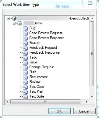

Open the Work Item Template from the server
Open Work Item Template from server
Open Bug template

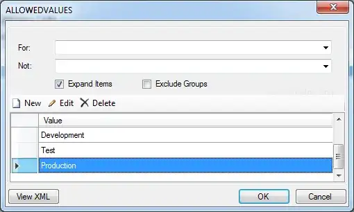

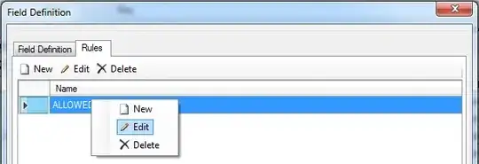

Then, click the Rules tab and edit the ALLOWEDVALUES rule:
Then, Click "New", and add in "Production" as one of the values.
Click "OK" repeatedly until you're back at the field list.
Save the Work Item Template
OK, now you're done. You can create new Bugs and indicate their type as Production. I'd also create a few Work Item Queries looking at Production defects, and add them to your pinned items. Finally, look at the existing Bug queries, and maybe change their ordering so that "Production" bugs come up first (if that's possible).
