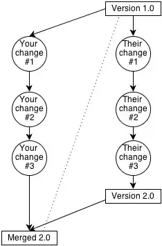

In getting a copy of the code and making local changes to it, you have effectively branched it. Meanwhile, back on the main line other changes have taken place and a 2.0 version has been released.
Note that these #1, #2, #3 do not need to match up, nor are they the same feature - just a representation of several changes that have been made to each codeline.
This is what it looks like now, and you are trying to make that merged 2.0 point.
Just doing a diff of the code at Your change #3 and version 2.0 will show you what has changed between the two, but it doesn't show how that fits in. Unless you have marked your code somehow, you will have difficulty determining if the difference between your change #3 and version 2.0 is changes that new features in the mainline, or changes you did in your branch.
For this, you need to use diff3 that that implements a three way merge of the your code, the oldest code, and their code. This takes the version 1.0 as a change.
