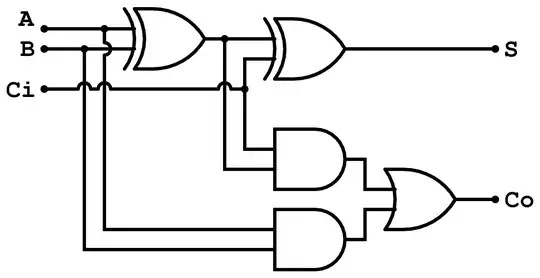

  1. Work in binary: 0, 1, 10, 11, 100, 101...
  2. Know your math: 0+0=00, 0+1=01, 1+0=01, 1+1=10
  3. Know your logic: or, and, not, xor...
  4. Find that the low bit is a XOR and the high bit is a AND.
  5. Expand the principle of one bit to 8, 16, 32, 64 bits
  6. Build it with logic gates.
If you want to know more, see my answer to How is fundamental mathematics efficiently evaluated by programming languages?
