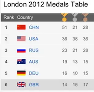

country_code is the ISO 3166-1 A3 standard country code, you can see them in the olympics.
