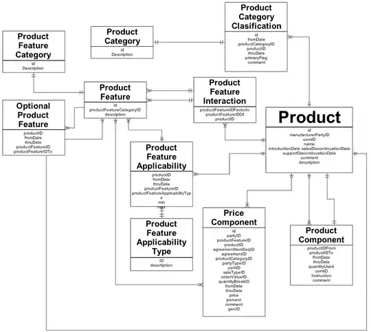

UPDATE #1
To better describe the problems at hand and to update the work done thus far to solve them I'm incluiding an ERD of the Product Model limited to the entities and attributes that affect the issue (i.e. inventory is not at play here, so no inventory entities are present).
I'm also including sample data from the entities and attributes that affect this question (to simplify reading the data, I'm putting in name/descriptions in place of Foreign Keys):
Here is a link to a flow chart giving an example of a combo, a fast and visual way to understand the table structure.

So, with the research and support provided by the community up until know, I have been able to solve Problem #1. In fact, I have done so with more flexibility than I thought I could do in the first deployment of the system.
All though there have been advances with Problem 2, it is not solved to satisfaction. There have been some ideas on how to do this, Neil McGuilgan asked a great question leading towards a possible solution using Relational Division (dba.stackexchange.com/questions/45829/what-is-the-name-of-this-type-of-query-and-what-is-an-efficient-example) and this book (www.amazon.com/books/dp/0471380237) helped a lot. However this solution at present, and as I understand it, only works with "one" record (combo) at a time. If a customer Walks up and says he wants 2 cheeseburgers, 1 hamburger, 1 small Apple Juice, 1 Coke, 1 French Fries and 2 onion Rings, I need a way to detect that there is only one combo in the mix and add the other products at base price. If there are multiple combo combinations, I'm looking (ideally for an sql query) that can prioritize combo combinations by largest savings.
One idea I've come up with to solve problem two is to add and attribute to PRODUCT COMPONENT flaggin the main product for the combo (i.e. hamburger). Then when running the pricing process, query what products in the order are main products in a "package", relating the query to the discount given by the PRICE COMPONENT table and ordering by that value (descending), and in that order of packages check to see if you can create a "package" with the remaining non-main products with a query and loop the process until there are no more main products or there are no more non-main products in the remainder.

  • What have you done so far ? Show us some ER diagram. – Tulains Córdova Jul 08 '13 at 15:52
  • @user61852 I do most of my ERDs by hand. Can you recommend a tool to do them on the computer so I can share it? (hopefully a free one :) – cml Jul 08 '13 at 18:20
  • @user61852 I found gliffy.com which is proving to be rather useful. I'm working on putting together what I've worked on to update my question. – cml Jul 08 '13 at 22:09
  • @user61852 I have added update #1 to show ERD, flow chart, advances and sample table data. – cml Jul 09 '13 at 01:58
