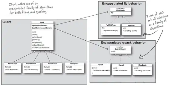

In Head First Design Patterns it teaches the strategy pattern by using a Duck example where different subclasses of Duck can be assigned a particular behavior at runtime. From my understanding the purpose of the strategy pattern is to change a single object's behavior at runtime, yet they are using inheritance of Duck to change the behavior of various types of Duck.

Is context inheritance of Duck irrelevant to the strategy pattern or is varying Duck types and also varying their behaviors a good reason to employ the strategy pattern? Do situations where you need to vary both constitute a good reason to use strategy pattern? Why would they include this as the strategy pattern example?

Yes, I think you are on the right track. The class using the strategy pattern does not have to be a subclass. The strategy pattern is an alternative to inheritance for code re-use. This comes back to the even broader comparison of inheritance vs composition.
From Design Patterns: Elements of Reusable OOP you would use strategy pattern to
  • Avoid an explosion of subclasses (due to combinations of behaviors)
  • If you need to swap out behavior at run-time
If you used inheritance to implement Quack and Fly behaviors you would result with all these subclasses to represent all the combinations of behaviors.
  • FlyableQuackableDuck
  • FlyableSqeakableDuck
  • FlyableMuteDuck
  • NoFlyQuackableDuck
  • NoFlySqueakableDuck
  • NoFlyMuteDuck
Having so many subclasses makes it harder to maintain which is why strategy pattern is favored in this case. You just need two properties which encapsulate Flyability and Quackability and you can mix and match these without creating new classes.
You also already mentioned the run-time benefit of if the weather changed the duck's Fly property could be replaced with a NoFly object due to the conditions.
This is consistent with the advice to favor composition over inheritance when possible.
