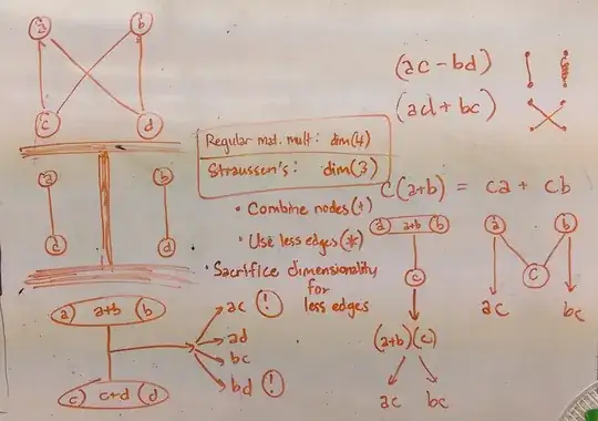

I've just been tasked with doing this for homework, and I thought I had a neat epiphany: Strassen's algorithm sacrifices the "breadth" of its pre-summation components in order to use less operations in exchange for "deeper" pre-summation components that can still be used to extract the final answer. (This isn't the best way to say it, but it's hard for me to explain it).

Edit: Here is a picture of my notes I drew in the process of making the complex number explanation:
Some notes for figuring out the complex number part.
