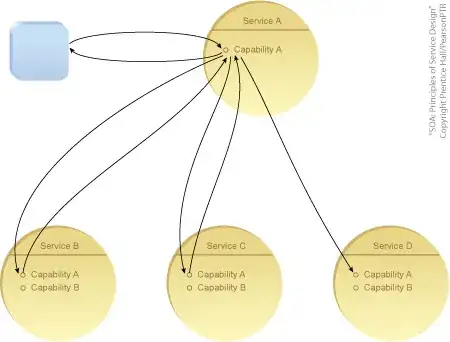

One of the main SOA service design principles is Service Composability principle (https://en.wikipedia.org/wiki/Service_composability_principle).
The idea is that by composing new services using existing ones as building blocks, one can rapidly develop new services. Kind of analogously to how you call exising methods of objects when you implement new methods. This is where much of productivity boost from SOA is supposed to come from.
Does someone really do this in practice? I have seen this repeated endlessly in written text, but have not experienced working real world implementations myself. Most of the text also omits any mention of transaction handling, which seems to me to be the biggest obstacle in realizing composable services.
First, you really do need to tackle the transactions problem before you can compose any non-trivial services. Sure, if the example has services "findCurrentTime()" and "writeLogMessage()" its easy to not worry about transactions, but not when having real world examples such as "depositMoney()" and "withdrawMoney()".
