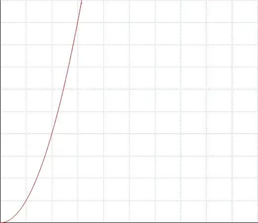

Given the case of many nested loops you end up with polynomial time. For example given this pseudo code:
set i equal to 1
while i is not equal to 100
  increment i
  set j equal to 1
  while j is not equal to i
    increment j
  end
 end
This would be considered O(n^2) time which would be a graph similar to: enter image description here
Where the y-axis is the amount of time your program takes to terminate and the x-axis is the amount of data.
If you get too much data your program will be so slow nobody will wait for it. and It's not that much around 1,000 data entries I believe will take it too long.
Travis Pessetto
  • 247
    you might wish to reselect your graph: that is a exponential curve not a quadratic one, also recursion doesn't make stuff O(n log n) from O(n^2) – ratchet freak May 23 '13 at 20:44
